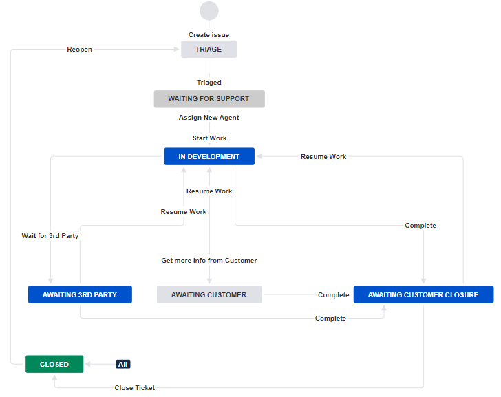

Simon Bell
March 9, 2022
Hi @Stefan Salzl I tried your suggestion whereby I've changed the Rule Actor to 'User who triggered the event'. This has closed the ticket but gave a different error:
"Unknown fields set during edit, they may be unavailable for the project/type. Check your custom field configuration. Fields ignored - Resolution (resolution)".
Where the ticket Closed, this field edit is supposed to set the value to 'Duplicate' which it's not doing.
I've included below, 1st the new Workflow where it's not working as it's going from Triage > Closed but seems to be prevented by the Condition thats set to only allow the Reporter to Transition. 2nd workflow below is the original workflow which we no longer use, but the AUtomation worked, as the ticket went straight from Creation and followed the 'Close Duplicate' transition.
2022_03_09_Workflow_01.PNG2022_03_09_Workflow_02.PNGThanks - we are edging closer!

Stefan Salzl
March 9, 2022
Obviously I was wrong: As it looks like it is possible to immediately transition to another status from entry point (as this is shown in your old workflow). Please appologize my missleading information 🙏🏼
I see 2 options:
  • designing the worklow similar to old one (adding the transition „Close duplicate“ that works around your triage status)
  • if this is not possible/desired then i would suggest to the actor is the user who triggered (=reporter) and also adding the resolution „duplicate“ with the automation rule (as this is a required setting obviously) —> tbh. i dunno by heart how or if the resolution can be set.

Simon Bell
March 11, 2022
Thanks - adding the transition from Traige to Close without the condition, has resolved this, thank you for your help!
