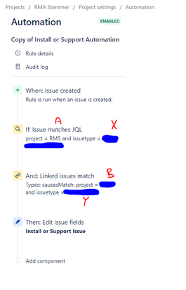

 Yes, so it should be triggered when an linked issue is created. I have the following setup:
- Project A and issue type X
- Project B and Issue type Y & Z
The support team ( works in project B ) will create a linked issue in project A with issue type X. The created issue in project A will either have Y or Z as a linked Issue Type.
Depending on that linked issue type I want to edit the created issue in project A.
This is my progress

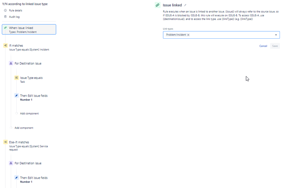

according to your description: I was thinking of another trigger -->
  • "issue linked"
    • You could then also choose on which link type the rule should react/be triggered.
    • It also depends on the direction/type your linking is going (inward/outward linking --> which issue will be the inward-side and which one the outward-side)
  • then I check the source issue within if/else
  • and add destination issue branch for each option
--> see screenshots below.
For better understanding of the use case I built:
I have a Service Management Project "ITSM" and a software project "JT". Within my ITSM project I have issue type "Service Request" and "Incident".
These issues could both CAUSE a task in my "JT" project ( eg. Incident (ITSM) CAUSES task (JT) --> indicent is source issue, task is destination issue)
So my rule triggers whenever a link of type CAUSES/IS CAUSED BY is created. When the source issue is an "Incident" the rule branches for the destination issue (which is the task) and edits it according to your requirement (eg. YES).
Else if the source issue is a Service Request the rule branches for the destionation issue as well but this time writes NO.
(In my screenshots is the field "Number 1". This needs to be changed according to your requirement).
Hope this was helpful.
Best
Stefan
