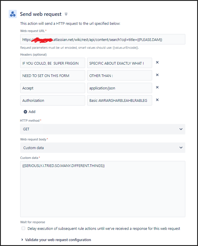

The problem is that I cannot get a smart value to pass in to the query, no matter how many times I try, how nicely I beg, or how loudly I scream at/near/adjacent to the sky.
Here is the smart value I'm trying to use :
{{customfield_10675.leafValue}}
And here is a computer once again leaving a hot steaming pile on my chest because it's jealous of my meat prison :
405 : Both the number of times I've hated this and the relevant error code. Neat!

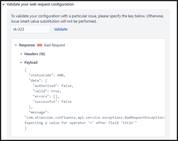

The point that I find raises my blood pressure more than a deep fried double down ice cream sandwich the most interesting is the "expecting a value for operator '=' after field 'title'". This tells me two things :
  1. That the (smrt) value is not being passed along whatsoever.
  2. My life was not supposed to go like this.
I have tested this with other Smart Values and get pretty much the same result constantly, which is frustrating. But even more frustrating will be when someone replies to this thread with the correct answer and it's both incredibly obvious and has been right infront of my big ol' smell horn this whole time.

Ok couple of things
  1. 405 typically means you are not using the right HTTP method to query - I can see in the above screenshot you are using GET but can you please double check in the actual configured rule - also you may not be able to use a Custom Body with GET if the CQL endpoint does not support that.
  2. Can you try with some other smart value if that is also not being able to resolve or is it just custom fields that are causing an issue ?

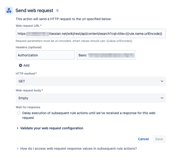

I was able to use the following successfully to call the CQL endpoint
Edit 1 -- Just tested it works for Custom Fields also. The catch is you would need to enclose the smart values in single quotes in your CQL query if the smart value is resolving to multiple words. An an example try using
https://****.atlassian.net/wiki/rest/api/content/search?cql=title='{{issue.customfield_10020.name.urlEncode}}'

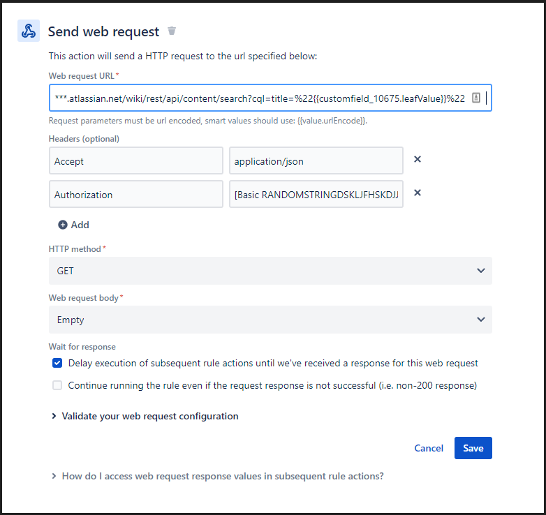

Alright - I've managed to get it to work.
I'll save the super-long explanation, but the behaviour I was running in to was because many page titles contained dashes "-", which wasn't being handled by the ".urlencode" tag. The only way around this was  and required a workaround by wrapping double quotes around the smart value, but pre URL encoded as in "%22".
This is what the final query looks like using the ".leafValue" of a cascading select list from a custom field (via Prime Custom Fields).

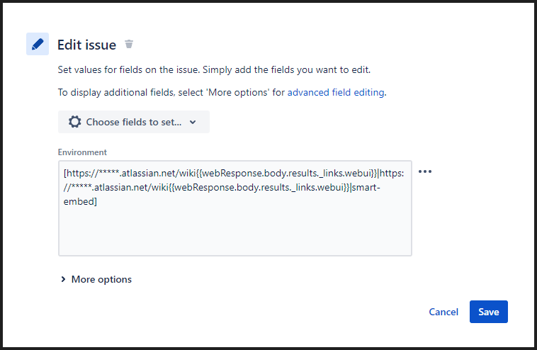

This allows me to extract the URL from the response and place a Smart-Embed of the relevant confluence page into a custom field using this string :
[https://*****.atlassian.net/wiki{{webResponse.body.results._links.webui}}|https://*****.atlassian.net/wiki{{webResponse.body.results._links.webui}}|smart-embed]
 Like this :
