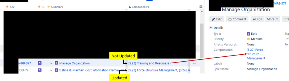

I'm also having a problem with Sturcture syncing to current Issue fields. I recently updated values in the Component field on two different but related projects. I updated the Component fields in the Project Settings>Component page, so the changes would propogate across the Issues that are already tagged with the respective component values.
For both projects, if I go into the issues, the Component values are updated. But in a Structure where I'm consolidating the two projects, for one project the component values are updated, but not for the other. I've looked in the issues' histories, and neither show an event for the updated Component values.

Thanks for the quick reply, David.
This is something that will happen on a regular basis. I was/am puzzled why structure picked up the update on one project, but not on the other. If it's because the triggering event doesn't get generated by updates such as these, then I'd expect we wouldn't see anything in Structure get updated at all. I was hoping to figure out why the one got updated, so I could get them both to.
Checking the issues this morning, I do see the updates in the Structure now. Nothing changed from my end user perspective, so not sure what it was. Perhaps a nightly process or something to that effect triggered the updates.
