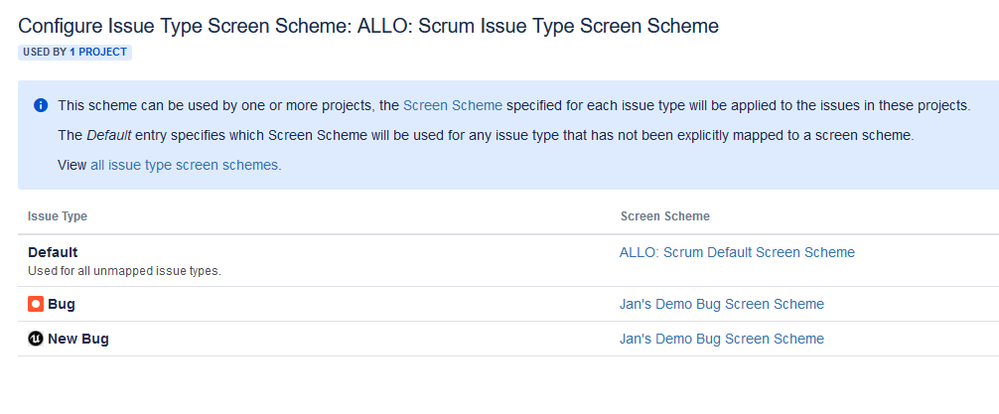

I think you need to supply some screenshots of Issue Type Screen Scheme and Screen Schemes.
Jan Dan
February 4, 2020
Yes - not the default one, a custom one I made a year ago specifically for the old bug issue type. I now want the new one to have the exact same layout, so I have tried to replicate all the same settings. The only thing that should be different is a different workflow, name, and icon.
I shall take some screenshots.
Jan Dan
February 4, 2020
Jan Dan
February 4, 2020

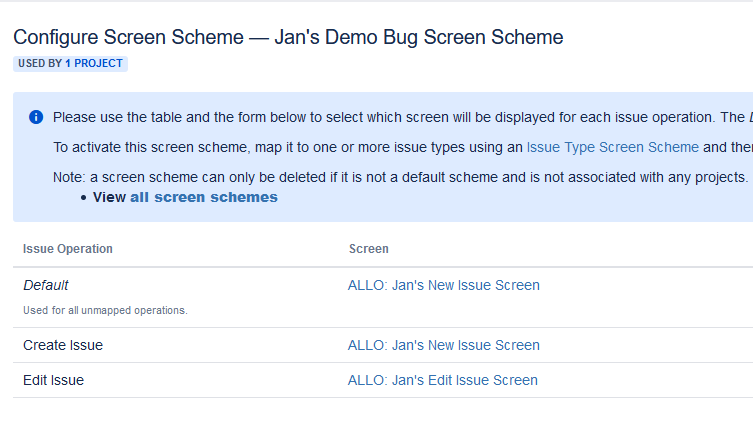

Jan Dan
February 4, 2020
So, the two issue types share the same Issue Type Screen Scheme, and there is a custom screen listed under the Create Issue Type - which does appear for issue type Bug, but does not appear for issue type New Bug.

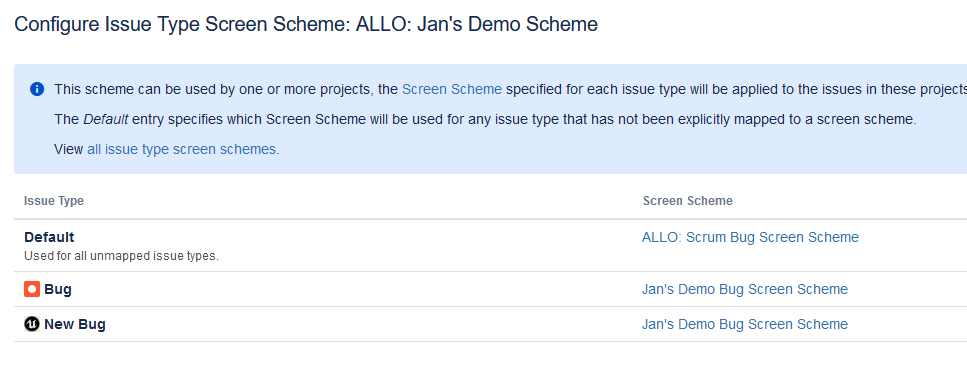

Can you go to Project Settings and check what's shown under "Screens"?
Jan Dan
February 4, 2020
So, after talking with one of our admin, I learned that the scheme used by the project is actually a different one than I thought - it seems theres been tweaks to my setup, to try and streamline it a little. However, when I open the other Issue Type Screen Scheme, it appears to have the same setup.
