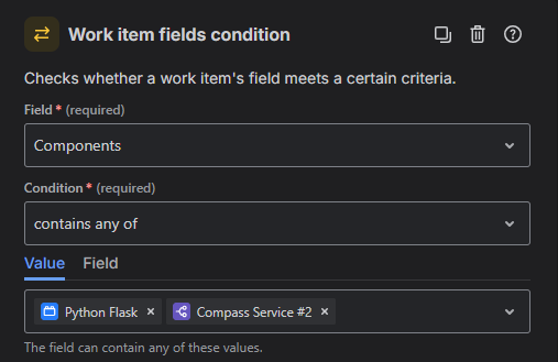

Are you looking at an existing work item and, based on the components selected there, you would like to create a new 'ticket'? Or, is it that for each component within the project, you would like to create a new work item once a bug is created? 👀
Generally, you could use 'Work item fields condition' and select/configure how the condition should behave based on Components field.

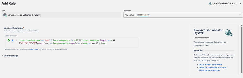

If using a third-party app is an option for you, i would like to recommend the Jira expression validator  from our app Jira Workflow Toolbox Cloud
By simply creating this validator in your workflow transition and entering the following Jira expression, you will achieve the desired result.
Here is the expression that can be set in the validator, along with a corresponding screenshot:
issue.issueType.name == "Bug" ? issue.components != null && issue.components.length == 4 && ["A","B","C","D"].every(name => issue.components.some(c => c.name == name)) : true
This would force the selection of the components "A", "B", "C" and "D" for the transition to succeed if the issue type is "Bug".
If you have any further questions, please feel free to create a request in our support portal.
