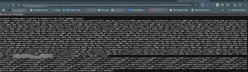

JQL = project = ISSM AND issuetype = Change AND resolution != Canceled AND "Planned start date[Time stamp]" >= "2025/01/21"
The path used to make the request was: search? + JQL
Comparing the two screens, the web screen returned only 2 results, but the REST API returned 3896032 ISSUES.

How did you construct the URL that you are using? Specifically, how did you insert the text for the JQL statement?
I created a search in the View All Issues page. I then modified the URL on that page to replace /issues/?jql= with /rest/api/2/search?jql=
I notice in your command you are missing the jql= portion. If I leave that out then I get similar results to what you get.
You should also note that endpoint has been deprecated according to the documentation.
https://developer.atlassian.com/cloud/jira/platform/rest/v2/api-group-issue-search/#api-rest-api-2-search-get
You should instead use the new endpoint:
https://developer.atlassian.com/cloud/jira/platform/rest/v2/api-group-issue-search/#api-rest-api-2-search-jql-get
