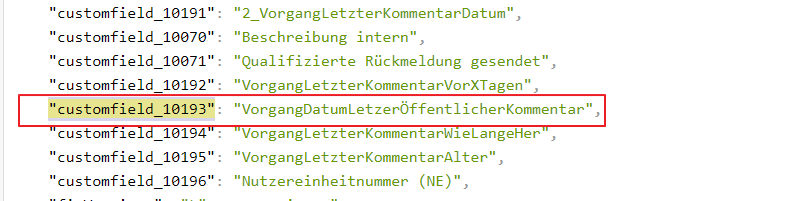

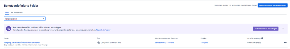

I got a Field of the type "Last Public Comment Date" with the Name "VorgangDatumLetzerÖffentlicherKommentar" where the timestamp from the last comment (not last public comment?!?!) is saved.

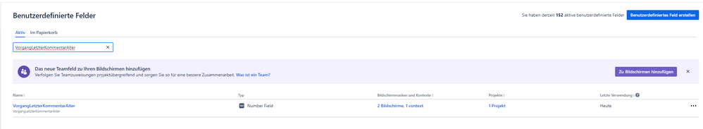

But we have to save rule executions now and because of that I want to use the "Last Public Comment" - Fieldtype to calculate the age of the last comment.

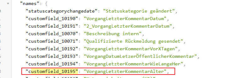

The result of the calculation then is set as value of a field of type "Number Field" called "VorgangLetzterKommentarAlter". In the .json view the value of this field always is "null".

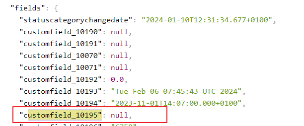

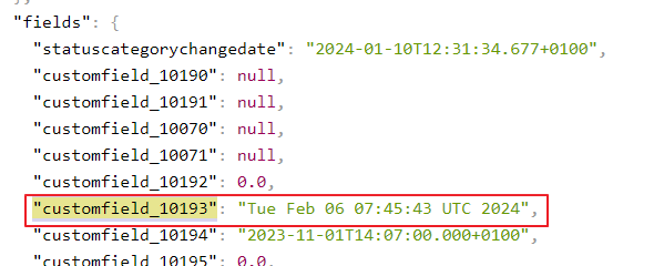

Hi @dahu
on your second screenshot the custom field has the value 0.0.
How did it get this value? Does it work sometimes?

Hello Kai,
thank you for your answer.
Because of value 0.0. I can not tell from where or when the 0.0 value came from.
Always when I do it again, I got "null".
No, there is no error in the audit log of the rule.
