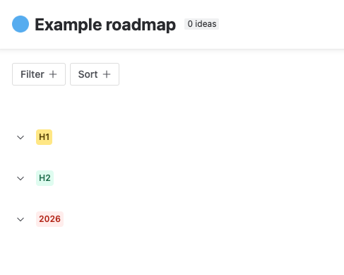

Hi, I have created several board views in my JPD project and I see that if columns are of the type "roadmap", sharing works correctly.  However when columns are "Objectives" (idea type similar to maybe "bets" in some of JPD examples), then if I (or anyone else) open a shared link, the whole board looks empty:

Hi @Tatiana Torset , yes we've only super recently build support for connection fields in Published views. It's not rolled out yet but coming soon (this month)
Tanguy Crusson
October 10, 2025
hmmm nevermind, my bad: it looks like it should already be deployed to everyone. I just tested and it works for me.
Could you please raise a support ticket? tell them Tanguy Crusson from the JPD team asked you to create this ticket so we can investigate a problem on your site, and that we require site access.
We'll figure out what's up.
Thanks!

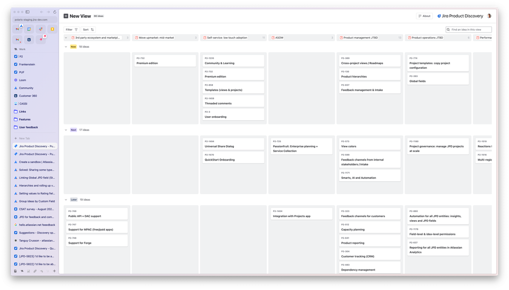

Tanguy Crusson
October 10, 2025
Tanguy Crusson
October 10, 2025
Sorry not sure if you will receive a notification unless I mention you @Tatiana Torset . See question above (I checked, and I was wrong: it's supposed to work)
