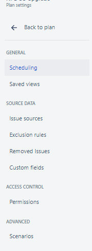

Thanks @Eddie Meardon - I think maybe there is a configuration with our Jira instance as I do not see the information you were proposing me to check:
All I see as options in the plan Settings are:
Thank you for your help

@Leyla Kinaze are you on a Cloud site or the DC version of Jira?
Leyla Kinaze
July 24, 2024
Eddie Meardon
July 24, 2024
That explains why you can't see the menu option I mentioned. Sorry about that.
In terms of what help I can offer from DC, we have a page in the documentation about how to find missing issues in Advanced Roadmaps but I think you've done most of these steps.
At this point, I'd recommend reaching out to support.
